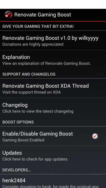

6. Optimale Power des Kernels für Spiele nutzen jetzt auch für AOSP ROMS !!!Probleme unter faux 004beta8
RENOVATE Gaming Boost v1: Für Custom kernels, Faux004b7 recommended, Stock Kernels, Super Fast
RenovateGamingBoost_SenseFramework
(für AOSP ROMs, es fügt die benötigten Sense framework system files hinzu , zuerst die .zip flashen, dann die App nutzen)
!!!BUT A WARNING FOR ALL KENRELS!!!
warning! due to HTC code, on many kernels including both stock and Faux, turning off the screen will reset two vital parameters set by the app
so you have to make sure not to turn off the screen between boost and playing a game, if you do turn the screen off re-toggle the boost mode
This is because HTC's code will always call back 1500 single core step and sampling down values upon turning screen on, i think its an issue with stock ROMs only
